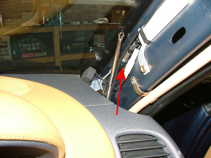

And this is the aerial amplifier. As Rodney suggests, if the screen has been changed it might not have been connected properly.
You have very similar symptoms to a problem I had, though my reception was worse with AM rather than FM.
Changing the aerial amplifier - illustrated in Richard's email - fixed it. Easy to do.

Unclip the coat hook (use a large bladed screwdriver and carefully lever up from the bottom) and you will see a screw behind it. Undo that to release the end of the trim, and pull it off from there, working your way forward. It is held on by metal clips, so be brave.
I have a similar problem which I'm trying to resolve. Is there any way of checking the lead between screen and amplifier without removing the screen?
