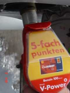

I hope you run on Optimax/BP Supper or indeed the new Tesco 99 octane, yes Tesco now have the highest octane rating, come on Shell pull your fingers out
Is Tesco's 99RON available yet? Anyway Optimax have V-Power on the continent with 100RON, I guess we'll be seeing that shortly....although the post '97 cars are designed to run off 98RON, so the extra won't really make a difference, unless the knock management is tuned to make use of it.
Give 100 please !
Yep Tesco have it, not sure if all locations ... Apparently I was the first they had sold at the site I went to in Kent
