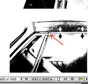

from memory on my 78SC and if we are talking about the same bits Ithink they are screw fixed from the top . I'll look at my car over the next few days and confirm .
Just looked , if the item arrowed in the picture is what you are describing then it is fastened in place with two phillips head screws.
Thanks Bones, but Porsche are a little more cunning than that, ...in the vertical spar that joins the top 'joint' there is hidden, i believe 2 rivets, but i dont know how to get to them!! The replacement units certainly have 2 holes in the vertical fixing strap!
I have a sneaking suspicion, that it has to be the door card off, slacken the fixing bolts to the vertical spar, undo the 2 screws you mention, remove the quarterlight glass to access the rivets....but I hope not.....
