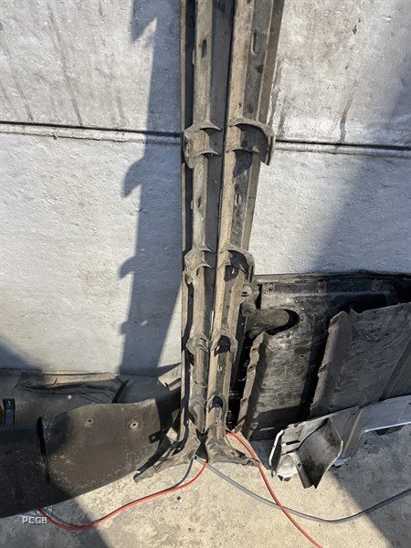

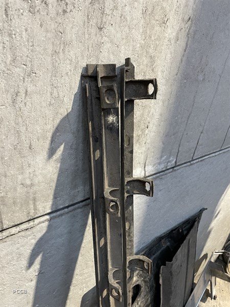

The moulding should bolt up - looks like yours has snapped and been tidied up. It's a crap photo here but this shows mine.
You may have to make some brackets (2mm steel should be simple enough to do) or invest in some new trims.
<a data-flickr-embed=
you can clearly see the brackets that attach to extended screws from chassis.
As I have just taken mine off, here is a pic of them and
This is very helpful Greg and Schnell many thanks - I now see that some creative person must have removed what remained of my brackets and pop riveted on some steel brackets that were then removed and the mouldings were glued on instead.

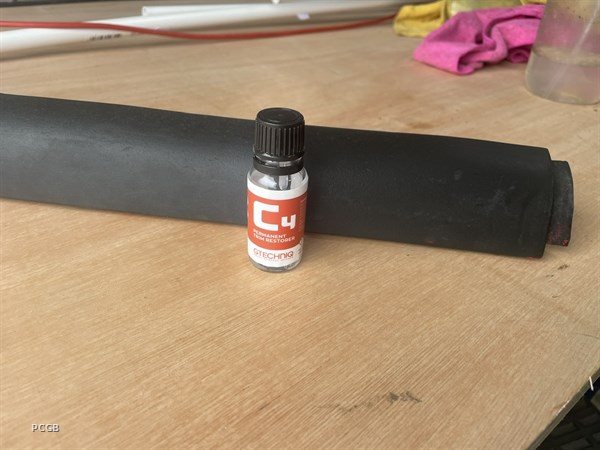

A quick test this morning - I washed the trim. On the right is with Gtechniq applied and to the left just cleaned.
