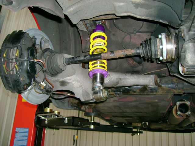

Attached is a photo taken before the mod.
It appears to be nice and clear at the std ride height, however as the wheel travels through bump, the spring cap moves towards the edge of the bush.
