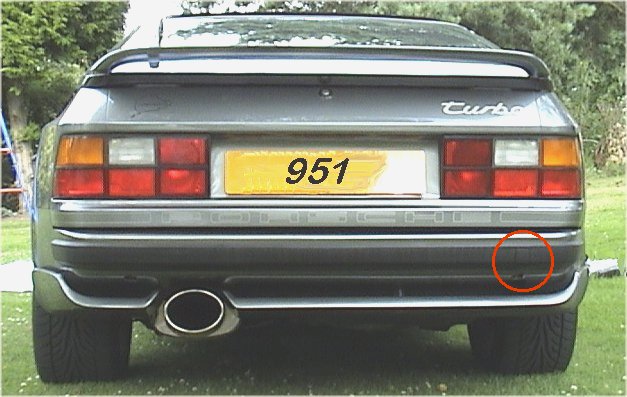

There is a square trim that removes and the towing eye screws in. You can just see it in this pic but I don't have any pics with the trim removed and towing eye in place.

However, my black rubber trim piece doesn't have that cutout (brand new piece) and the bumper has no cut out in it either in that spot. The bumper has a 931 part#, and was made in 9/82. Do the earlier cars have a different provision for tow hooks?

Not sure, the earlier cars without under spoilers may well have had a fixed towing eye, hopefully someone will be able to answer your question, ( I will keep an eye out for an early car though)

Here is a photo of the tow piece I am speaking about (just so that no one thinks I'm crazy[;)] ):
If you look close, you can see there is no little square cut out on the black trim on this 951. Granted, I'm certain the car is not "stock", but if there is no cut out on his trim there must have been other provisions to start?

Yes, a 931 is the internal name for a 924 Turbo, so I guess they had the tow hook in a different place [&:]
I don't know how handy you are with a craft knife, but you 'could' cut out the hole and one of us could send you a bung from a UK breaker? It has the potential to look really awful though [:eek:]
