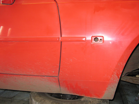

How can i remove these strips running accross the door and slightly into the wing? Im guessing they might pry/slide off but I would like some confirmation before I get at it.

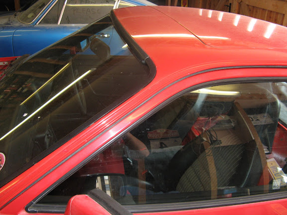

Also theres a strip that runs above the top of the doors. It can be seen in the pic below. Does that just pull off?

The door protector strips do pull off, I'd gently heat them first and they will peel off although they will probably leave the rest of the adhesive on the paint which can then be removed with various chemicals (can't remember what we used now, but things like tar remover/petrol is probably fine). You may have to use a wheel to get the very last of it off, it's terribly strong stuff.
I'm not sure about removing the gutter on an '84 car, i'm sure someone will be along who has done it, but I suspect it'll be a push fit.
