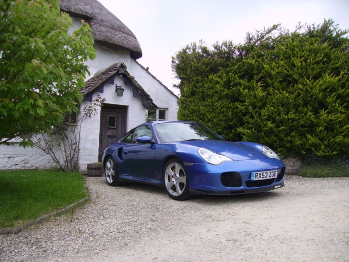

Thanks John.
I still have my tweaked 944 turbo. Logic says I don't need it and it will probably go but I'll maybe hold off for a little while.
I've found the electronic oil gauge but if you add oil when its cold its hard to gauge how much difference you have made.
I have no idea how accurate the "250ml per bar" on the dash is.
Richard has already been very helpful I hope he will continue to be (I'm sure he will!).
Pic enclosed.
