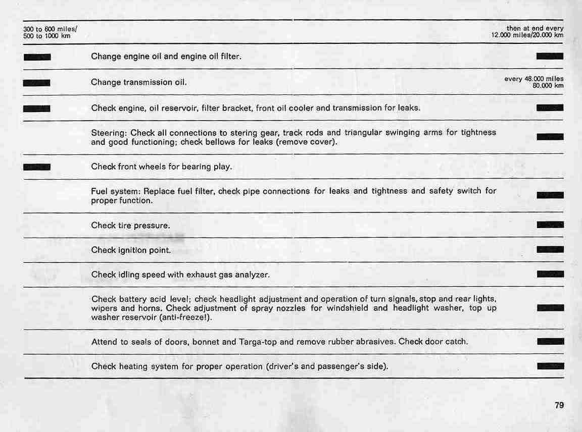

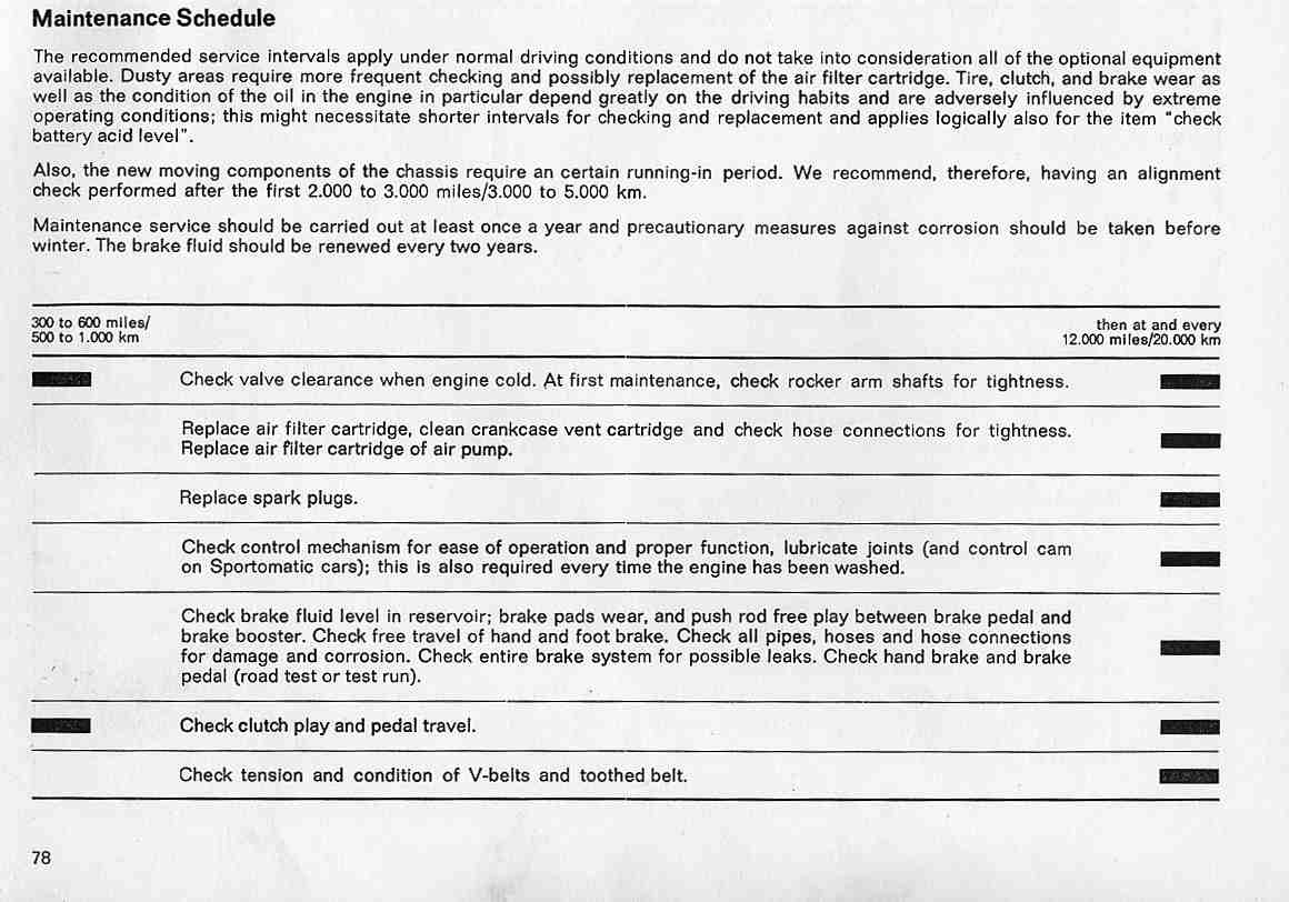

I am trying to find out what should be done at the 6000 and 12000 service, could someone please supply a list? I did try the search, but did not find any good information.

I just want a list to make sure that all is done during the 12000 service the garage is doing this week!
the basic service is in the pics.
