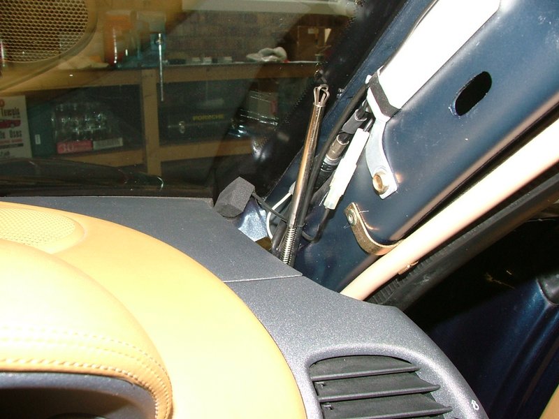

Hi, can anyone tell me where the radio aerial is?
Is it on the front window in the lower right-hand corner(if you're sat on the driver's seat) - as there seems to be a crack in the black sealant on our front window in this corner - and the garage said that this is where the radio aerial is and it is a common problem with teh boxster.
Yes, it's at the bottom of the driver's side A pillar behind the trim. You can just about make out the amplifier and wires in this photo:
I'm guessing that you're gettting delamination of the window where the aeriel wire works its way between the glass (lower right corner) through the bottom, then runs up the middle of the windscreen.You will often see a milky whiteness in that area. The problem is common. You can claim a new windscreen from your insurers by just paying the excess.
