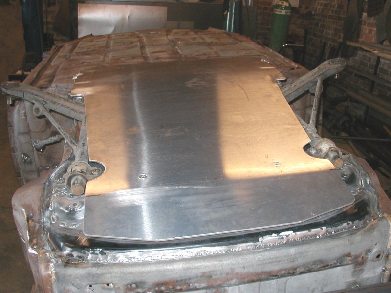

The petrol tank on my 1971T is taking a hammering each time i drive into my car-park at my new flat... The latch which the electric gates close onto sticks up about two inches.. but the angle of attack up a ramp then over the latch, is causing a (gut wrenching) scraping noise each time i drive in and out...
The rear of the car glides over it...
Does anyone know of a bolt-on solution , such as a sump-guard/ skid plate?
A midnight raid with an angle grinder may alienate me from my new neighbours...

Tuthills definitely do them, and Prepfab do a front bolt on kit for £340 plus VAT on there site :-
http://www.prepfab.co.uk/porsche.htm
doog
i have got a proper porsche tank guard on my RS (original sticker/part number) that i pinched off another RS i had over 20 years ago that had been used in competition in Switzerland.
It is very unobtrusive and only protects the tank.
It really doesn't look to difficult to copy for someone a bit handy in metalwork. I have got to remove it next week and I could send you piccies of it if you like.
It certainly has saved me the cost of a replacement tank!

Would be good if you could post some pic's on here . . . . as I'm sure people would be interested . . . well I would be.
Phil
Thanks for all the replies guys.
Definitely some good suggestions.
Nick. Photos of an OEM part would be perfect. If you can post them here great.. If not could you email them to direct..
