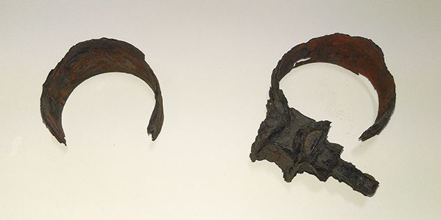

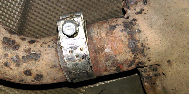

From experience, another cause of an annoying rattle is from rusted exhaust clamps on the rear box. I recently replaced these which had failed completely....
As I wanted a better solution, I fitted stainless steel Mikalor clamps for a fraction of the cost of the rust-prone Porsche supplied items. It took less than 20 minutes to fit without jacking up the car. These cured the rattle completely...
Worth checking before replacing the heat shields.
