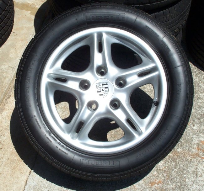

Unless my memory is failing me, I think the only 986 16" Porsche used looks like this.
I bought a set of 16" Boxster wheels & tyres for my 2000 2.7 to replace my 17" wheels for the winter intending to change them back for the summer. In normal driving I noticed hardly any difference at all to the 17"'s so left them on for the summer - £200 for 4 wheels and almost brand new tyres - cheap rubber!!
