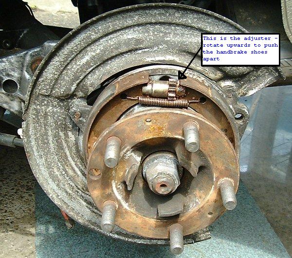

In case you need a visual image of what the adjuster looks like ......
The adjuster is accessed through the large hole in the bell / hub and can be turned with a flat screwdriver.
Hope this helps a little more.
