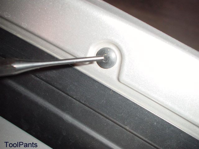

Well i had a go at the weekend and can see all the components i need to get to, but just can't get the 3 black bungs out of the spoiler. Is it possible to get repacement bungs so i can just cut them off? i feel that if i try any harder they will break anyway, or damage the paint work surrounding the bungs. is it normal for them to be THAT difficult to take off? looking through the cross section they are splayed wide at the back? Please help!
We call them plastic rivets. If you look closely you will see a round pin in the middle. You need to push that pin out of the rivet. Use a small punch or the end of a small drill bit.
The pins will fall into the spoiler. Once you remove th spoiler you can retrieve the pins. The rivets and pins are reused when you put the top of the spoiler back on.
That's a bit easier! Thanks for everyone's help. think i've managed to lose one of the pins though, somehow.
