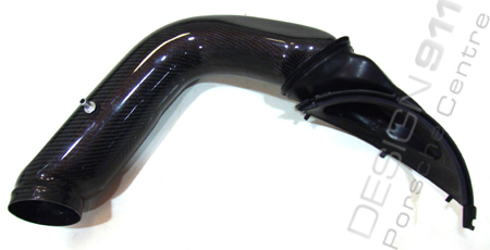

I recently bouth from ebay.uk a carbon rear fan bypass, after spending an hour, I could not get it to fit, the ruber on top of the fan is not adjustable and the bottom is not etheir did I do something wrong ? any ideas

Assuming the part you bought is the correct part. The part shown on the Design 911 web site seems to also show a replacement for the rubber part that fits over the top of the alternator fan. I wasn't aware that it was necessary to replace that part, but it's curious that they show it.
There's not really much choice - there are only two ends, and it can only go one way or the other.

That's the normal fan air duct in the Design911 pic. You can see a bypass pipe (albeit the OE plastic version) fitted to the normal fan air duct in this thread:
http://forums.rennlist.com/rennforums/964-forum/568636-pulled-the-a-c-compressor.html
The other end should fit in the rubber collar on the heat exchanger.

thanks for your replys, the botom part fits very well but it is at the fan rubber that it doesn't, it is missing 5mm to fit, the angle is wrong, unless as Dave mension it may need a different rubber who has a different angle , i looked at the Rennlist forum but did not see anythink about a special rubber, I will contact Design 911

Konstantin, if you loosen the three bolts on the rubber fan duct there IS a little bit of give but my guess is that you won't get enough to make up 5 mm. It sounds like Totyfinalist you have found that the aftermarket CF bypass is not up to the job. I'd be asking to send it back for a refund if I was in your shoes.

I try to loosen up the ruber from the 3 bolts but there is not enough give to make up 5mm, I think it will need to back to Japmagic, what a waist of time for such a small modification,
