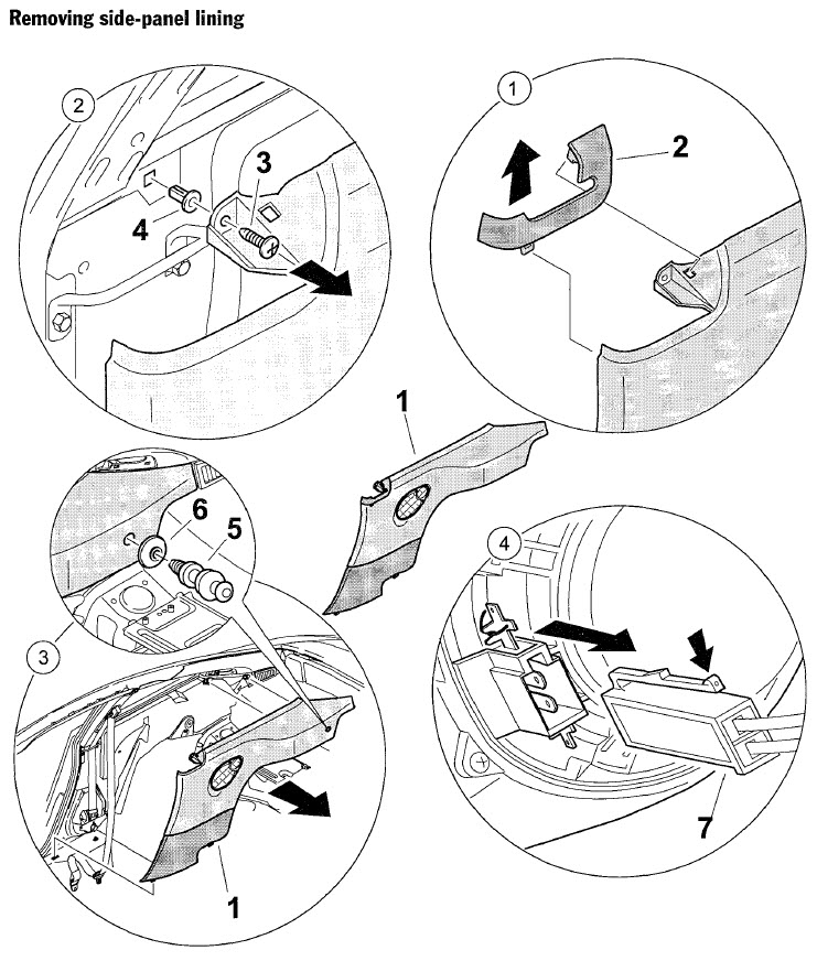

Hi
Does anyone have a picture to show where the clips are on the inside of the rear of the inner speaker side panel, I've read a few threads which explain how to pull the cover off but i can't find anything with pictures & I'm not convinced with what I've read, it's not my car so i don't want to break any clips off or damage the panel.
The car is an 01 996 Turbo with Bose.
Karl
Is this what you need?

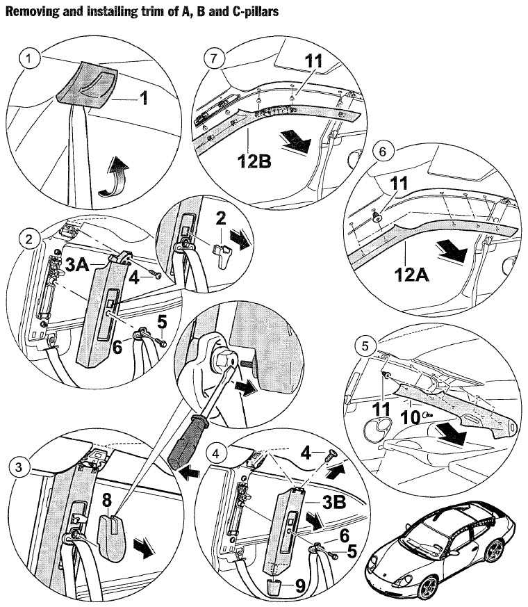

Looks good, so remove B pillar trim, then trim around back of side window which will then allow the speaker panel to be removed.
Thanks Richard
I don't think you have to remove the trim around the rear window (C pillar). Just the B pillar trim, so you can get to the screw at the seat belt opening.
