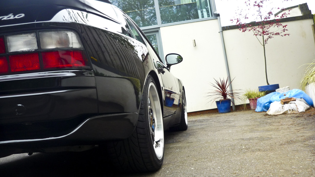

I'm also often asked about the clear fog lens. I stopped making these some years ago, but for those intent on on it, you can use the reverse lenses removed from another set of lights. Here's a pic from one of my customers would did that...
[/IMG]
