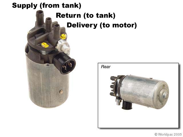

Am I correct in assuming the pump you illustrate is the £500 plus one? This car is non-standard in many respects and was fitted for a short while with a GSF pump which their catalogue indicates is suitable for rear mounted and MFI examples. The return by-passed the pump (not my fitting I might add). The intention is to replace the GSF pump.
