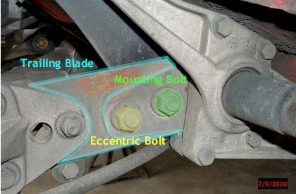

Greg, it may not be as bad as that. The rear ride height is adjustable via an eccentric bolt. It 'could' just be that this bolt has loosened when you overloaded the car and it's now sitting on it's lowest setting. Look at the picture below and David Sims website for more info: http://dialspace.dial.pipex.com/prod/dialspace/town/pipexdsl/s/asco96/944t/suspension.htm#Ride%20height
