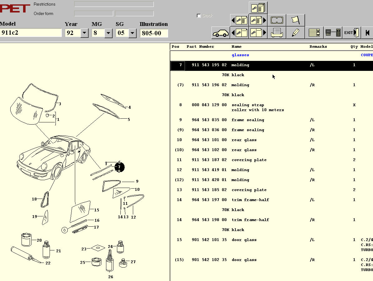

[FONT=verdana,geneva"]Try as a I have, in the PET catalogue and the workshop manual, I can't find a part number for the flat black aluminium trim that sits on the body and under the window rubber seal a tad. It's the black trim piece that lays flat/horiz then tapers off towards the rear. Doesn't seem to appear as a visible part - the seals (internal/external) and ally seal trims/corners do but that's it, not the external piece.

Its in Pet ..under Body and the rear side glass
Number is 911 543 195 502 for the left and 911 543 196 502 for the right and its not cheap for what it is, but I replaced both of my ones as the paint started to bubble. Repainting didn't work for me as the alloy is very soft and gets eaten away with corrosion and looks a mess after.

[FONT=verdana,geneva"]This is great Ian - thanks. I had no idea it was that part.. I thought it was an internal element inside of the glass from the way the diagram stacks the order.
