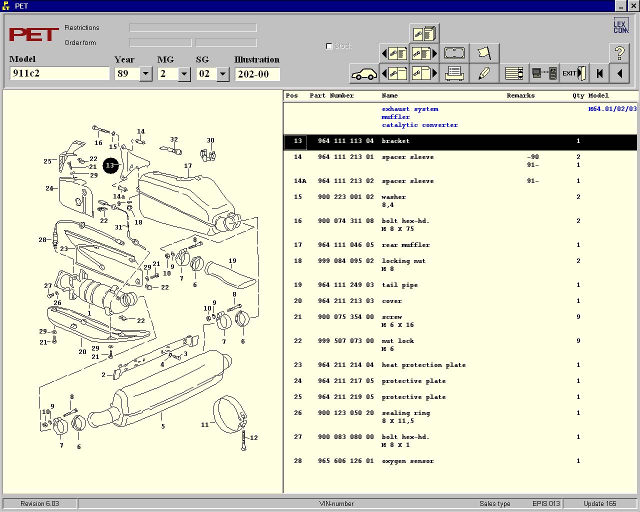

Graham,
The PET diagram might help you identify which part you are talking about. It will also get you a quick response from the OPC.
