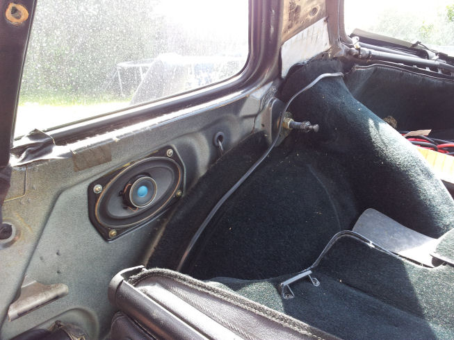

It wasn't necessary for me. Attached is a photo of the original speakers prior to me removing them and screwing in the replacements.
