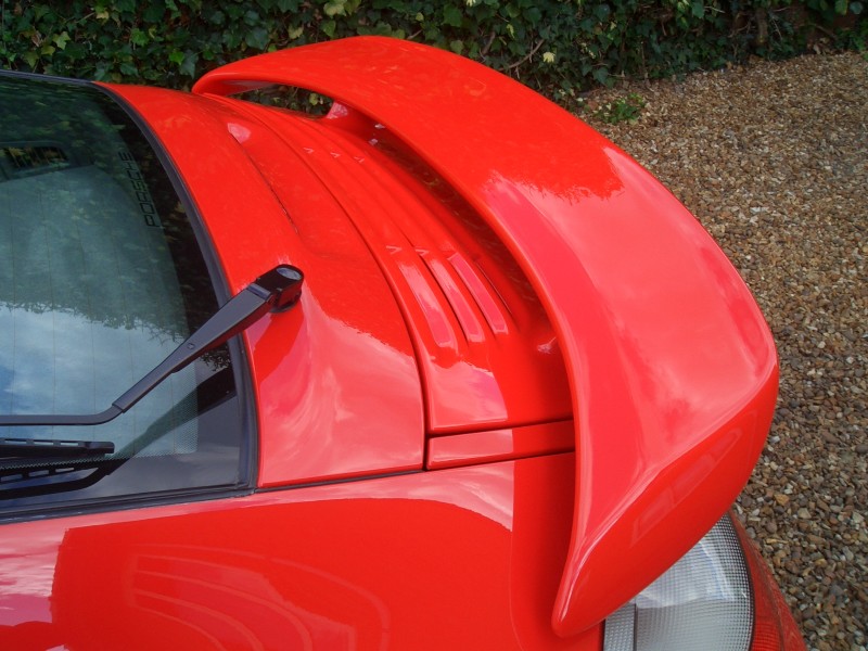

I finally fitted a TechArt spoiler which I am very pleased with. It is easy to fit and the car can be returned to standard if required. The engine lid is retained and the original louvre type spoiler is replaced with the static one shown in the attached pic.

Thanks for that Steve. [Nice colour Guards Red.... but then I'm Biased....] I paid a visit to Specialist Cars at Malton to get some inspiration....they had a 996 Turbo so 'popped' the lid and sure enough the 'rams' would go straight through the Airbox on mine....Hmmmmmm! They had a Silver Turbo lid in stock and offered to fit it but I could see it wasn't going to be straight forward so I think like yourself it's an 'aftermarket' Jobbie for Me! I'll look up the TechArt on the Net......[I think after the wide bodied 22B Subaru with it's adjustable top wing, standing nearly as tall as the car...the Spoiler for me has to be a bit less 'discreet' than the Turbo Anyways]....Then it's the front lower lip and she'll be right as they say!
That wing certanly adds something to your car, by the way... Looking Good!
Well I got the Misha 911.com GT2M wing for the C4S It was shipped Monday the 15th and recieved on my doorstep in the UK on the Wednesday....straight to paint used a Company called 'Pride and Joy' in Middlesbrough who sprayed and Laquered it with a perfect colour match. it came with a CD with 200 pictures after 15 min's to scan that I was in the garage and the Electtric one was out and the new one sitting in place...Looking Good, even in it's primer...fitting took about an hour.

Hi C4S al It certainly gives the car Prescence it looks VAST! I am going to fit the Turbo Chin spoiler colour coded of course and probably the Techart Type 2 skirts mind this is a grand plus option on the sills! The GT2M Wing is a DIY 'jobbie' if you are Handy or you you could let a Body shop do it for you you need a short harness for the fixed wing car part number 996-612-070-51 otherwise the warining light comes on as you Blast past 75 [who said that?] The Quality is excellent with little 'prep' work for the Painter......As long as you live nowhere near me......... I recommend one........I Want mine to be 'Unique' a little while yet....Just kidding
