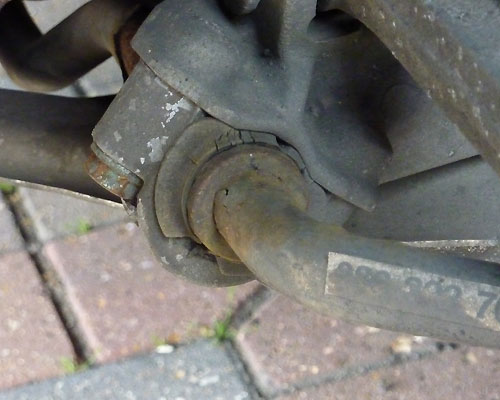

Hi, I also have a 'Clonk' from the rear suspension that I am trying to trace. The anti roll bar bush looks worn to me (please see picture) does anyone know if this could be the cause? Thanks
It definitely looks to be a prime candidate, and from what Pacemaker said above may as well do it to discount it from any list.
