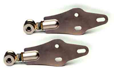

The new part http://www.gprparts.com/shop/product_info.php?products_id=234
911 964 Rear Spring Plate Set
[964RSPLT] $750.00
This kit replaces the factory spring plates and compliant rubber bushings with a precision rod end that allows for friction free movement and easy adjustment of toe angles without affecting camber. The precision rod end also improves driver feedback and maintains alignment settings for better handling. The plates are fabricated from alloy steel and nickel plated for strength and corrosion resistance.

Hi Steve, I've been seeing some grease around the chassis end bearing and assume that the bearing is shot. I expect that after 18 years and 97k they are well worn. I wouldn't consider 2nd's as they are probably just as bad or at the best on their way out.
All I need is the bearing replaced and if I could leave it on a ramp for a few days/weeks could get it replaced at an engineering outfit I know. But I don't have that luxury.
As for using Porsche Parts, at these prices I'm feeling sh*fted. Knowing that the bearings probably cost £20-40 max.
These Race parts are designed and used for cars with a lot more stress than I'm ever likely to put on them.
So I'm interested in knowing if anyone this side of the Atlantic has used them.
