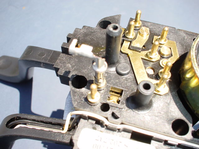

100 years ago a local guy hooked up something to the wiper stalk. He did not have headlight washers. When you pushed the wiper stalk forward it turned on something. It has been so long I do not remember.
I played around with this back then. I even bought the silver connector from Porsche that goes on an unused pin on the back of the switch assembly. If you hooked up a wire to that silver pin you could use the wire to power something. I think. Been so long. But I did take pictures back then.
