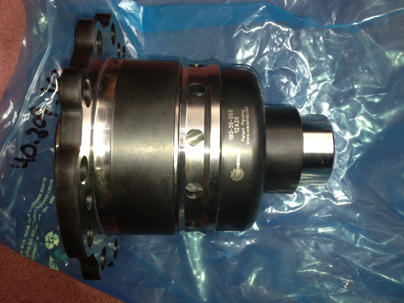

My Wavetrac arrived this morning.

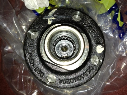

Hi , did your indie by any chance take any pictures of the insides of your worn lsd and what exactly was incorrect about the replacement vane set from porsche,Was it a ZF lsd or the later GKN version? Also how did your indie determine the wear on the friction plates as there is no specification from porsche?? only a torque figure for the diff to slip when out of the box and on a bench??

No pics I'm afraid. However, I did keep the old lsd and I daresay I could dismantle it and take some for you if you'd like.
My indie's a man of few words - no salesy bs. He says that what was incorrect about the replacement vanes was that "they didn't fit". He said something was a bit odd about this part when he ordered it - it wasn't 'tied' to the G64/20 gearbox - Porsche agreed and said they'd take it back if it didn't fit - which it didn't.
No idea if it's ZF or GKN. I took the attached photo which I hope will give you some clue.
He used the torque reading to determine that the lsd was knackered. Also the car's done 165k.
