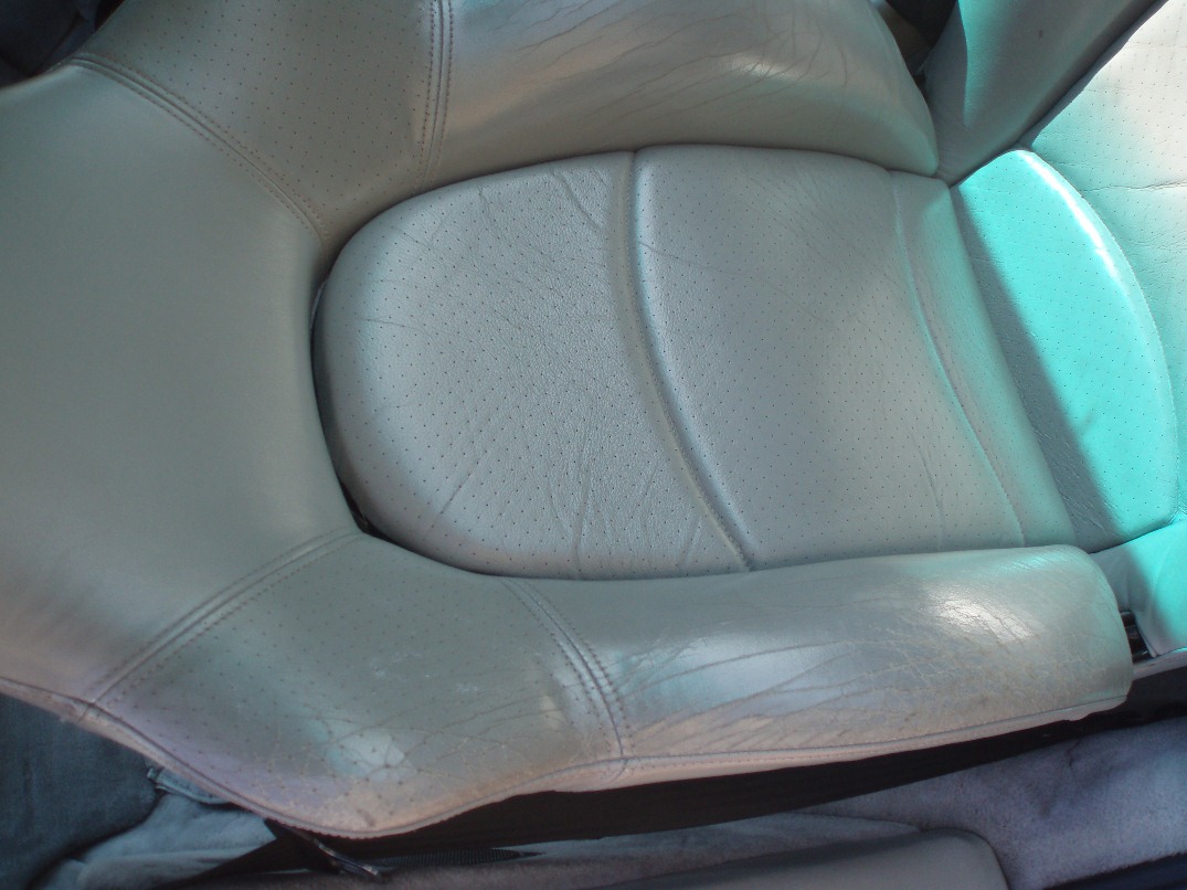

Just like to report that with the use of seat dye(glympton) i "redyed"(repainted) the front seats of my 993 cab which were Marble grey. It took about 6 coats spaced out over a week and I used a sponge to apply used just over half of the 250ml bottle, bought the kit. The number of coats was to get a solid colour with no streaks. You are basically applying until you get a consitant colour.
The finish was softer and nicer than the reconnolised seats I had done previously and about a sixth of the cost!
Happy now that after one attempt that if I can do it, anyone can do it!

This is before and the after should be attached to the original posting!
There was plenty of cracking, small patches completely worn through, for the cracks you are meant to fill them a bit with the a few layers first instructions with bottle. I did the whole of both seats.
One thing youll notice is the true colour of the marble grey is about 10 shades lighter! than the dirty old grey colour they are now. Marble grey almost looks cream in bright light. The difference in picture is actual.
If you dont want to do the whole seat by a 60ml bottle and just touch up the cracks with a couple of layers which will keep the damaged area as dark as the rest of the seat as the darker damaged area will darken the dye. If you put anymore on you will have to do the whole seat to match.

Well its £37 for the 250ml bottle which is about a 30th of the costs of recovering two seats and therefore if you dont like it and it only lasts a few years you've not lost much
By the way wear and tear will be more down to mileage/ getting in and out of the car.
