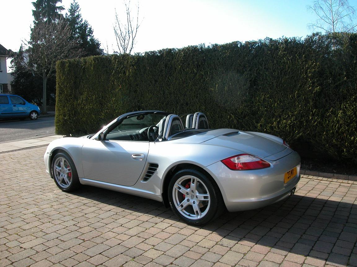

Checkout this debadged rear end and you may decide to stay unbranded too [;)]
