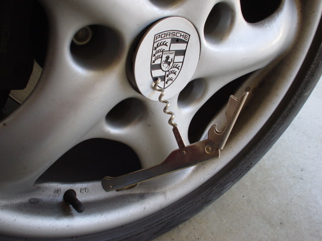

I know a crazy Boxster owner that uses a corkscrew
Probably best to drink a bottle first in order to summon up the courage to give it a try!
...and what happens if you cork them when pulling them off? straight back to OPC for another set ... damn! [:mad:]
