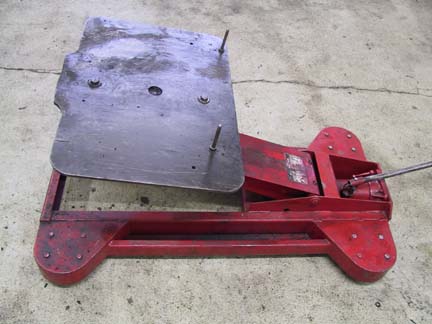

I thought of welding up my own kind of support bench in a way to stabilise the engine when supported - will post how it goes when I get around to dropping it out for maintenance .... thanks again for your advice guys :)
This a lift for a 911, but you can see the idea. You must be able to stop the motor tipping to one side or the other as it comes out
