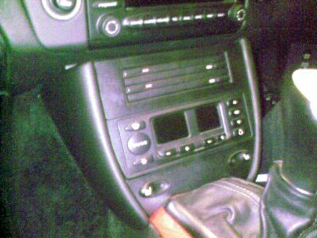

My next project on the car is the removal of the telephone handset from the passenger side of the console.
The car has full leather trim and I want to know how to remove the phone safely.
Are there any problems doing this and how is it done?
I do not know even if the handset has a purpose.
Any help would be appreciated
I also have Tooki and have managed to sync both my iPhone and Porsche Phone with only as I remember the issue that contacts can only have one phone number that Tooki will recognise. So if 'Mark' (One contact) has a Home, Work and Mobile you have to save those as separate contacts ie Mark Home, Mark Work etc.
With regards to the handset, I believe there is a T20 or T30 bolt on the small carpet trim in the foot well forward of the leather trim panel, remove the bolt and carpet trim to reveal two more bolt on the trim you want to remove.
Having remove those grab the trim at the rear and pull towards the rear of the car (not sideways), it should then unhook itself.
btw I think you maybe left with hole in the leather trim if you remove the handset as I think the panel is different to that of the non-phone one.

In terms of the phone holder, my concern is that once I remove the side attachment it does not look the same as the side panel on the drivers side. Where do I get a replacement?

Ah, yes, this is a problem. The replacement flush leather trim is ÂŁ350. I bought the leatherette version from Design911 for ÂŁ39 instead. It doesn't match the driver's side, but you don't notice too much...

I can live with ÂŁ39.
Did you remove the handset as well?
Was it difficult? and how did you disconenct the phone

The old phone simply unclips like removing a network cable from the back of your laptop - it's an easy job. The new flush side panel then clips in over the top - no screws required.
And the side panel - Just a couple of screws like Nick said.
