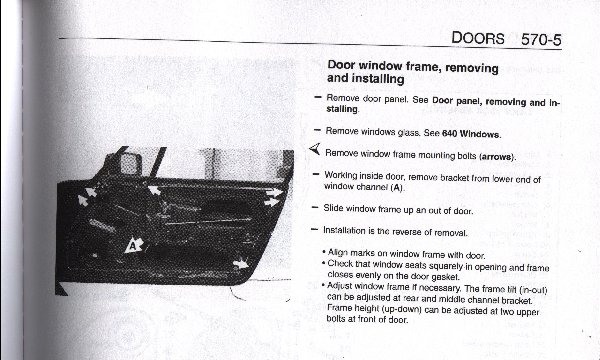

Steve - Bentley says you do remove the door trim to remove the quarter lights.

Steve
Don' t know if they are the same doors, but the attachment is from the 3.2 Carrera service manual.
I have removed my front quarter light, and it did involve the removal of the door panel - which wasn' t fun, when the hardboard is decaying!
Ant
PS if you need a higher resolution picture, let me know.
