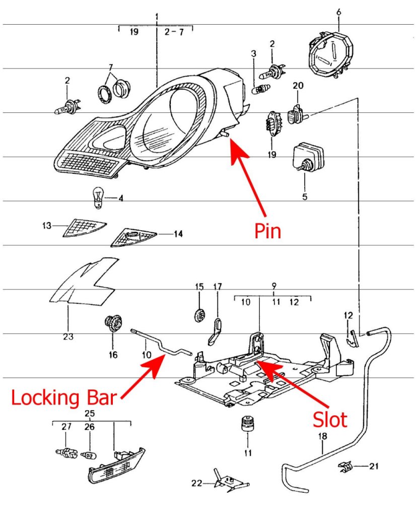

Getting the headlight units out - I've followed the handbook and turned the toolbox socket thing 180 and the headlight unit has released from the wing about 1 to 2 cm, but that's it. A gentle pull didn't budge the unit any more - do you just have to pull really hard, or have I missed something.

After it has released, twist and wiggle the socket as you pull the headlight unit. It should come out quite smoothly.
Edit: There are pins on each side of the headlight unit which go into slots in the carrier frame. The cranked locking bar (in the frame) locks into the underside of the headlight.

Don't forget that having turned the handle to release the unit you'll need to turn it back slightly to ensure that it's fully disengaged. Should slide out very easily then.
