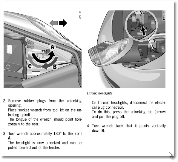

OK - here is the relevant page from the manual:

ive been trying to undo the wrong nuts, ive been in the 3 flaps. cheers that's great [:D]

well that was easy now i know which screw to be turning [;)]
