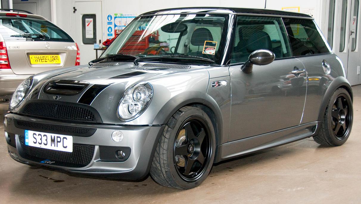

That's pretty much it for pics of it in this hemisphere. It's just a grey Mini with black wheels and some carbon fibre bits in any case. This is one of it just before it left and apart from the number plates and having the front windows tinted to match the rears now it looks exactly the same.
I like that a lot - what are the wheels Fen, as I don't think I've seen them on a 'Maxi' before....?![;)]
