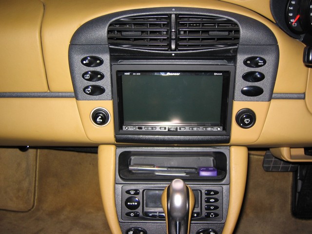

Most people replace it with a cubby hole. You can get a CD storage box to go in there, but it is a bit pointless as there isn't a CD player in the car. This is what I did with my 996C2 some time ago:
