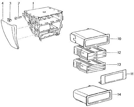

I want to install a Harmon Kardon iPod interface unit and intend to make a panel to replace the CD trays in the centre console to hold the display and controls. Looking at the CD trays they must clip out but I wondered how. I thought I would ask before pulling it about and breaking a vital plastic clip or something more drastic.
Yeh, as richard says just press all the trays so they all come out and just pull the whole thing, it then comes out with no damage
Thanks for the advice guys. Does just pulling bring out only the CD trays or the whole panel? If the whole panel doesn't come out, how do you get it out when the trays are removed? I have seen some photos of the assembly pulled out so can picture it in my mind. I just don't want to break any little plastic clips that will result in something daft like a whole centre console being needed. I am finding the Boxster very different to the 944 where things were screwed in, if you pulled it and it didn't move look for a screw.
ORIGINAL: colinbythesea
The whole assembly of the trays in their carrier comes out in one piece. Edit: Item 13 in the pic.
