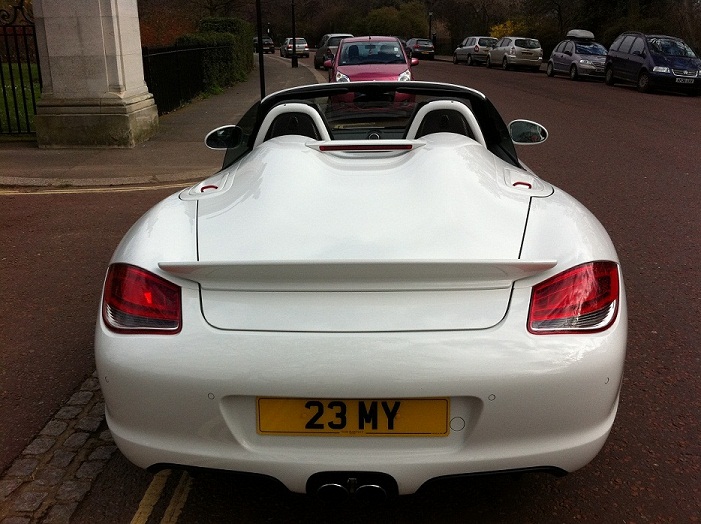

Flossed mine off after a good soaking with extremely hot water from a recently boiled kettle and liked the clean debadged look so much didn't bother putting the spyder badge back on [
![0F5F2C63FAA14BF7ABA297621B7BB637.jpg](https://www.porscheclubgb.com/forum/legacymedia/upfiles/160/0F5F2C63FAA14BF7ABA297621B7BB637.jpg)
