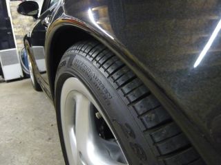

Thanks to everyone who replied to my query on the tyres. The clearance is small, but looks the same as the picture posted, so I'll stick with the p zeros and see how we go. Thanks to everyone who responded as I don't know anyone else with a c2s so had nowhere else to go
