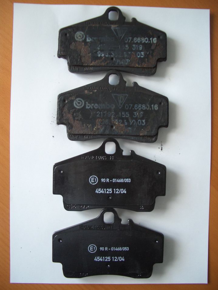

Well, the difference on the Textar pads I got for my Boxster instead of the Porsche ones that were about 50% more expensive was the fact that the Porsche ones had "Brembo" painted on them. Literally that was the only difference, as they both had the same Textar part number on them. Look at the bottom left hand side of the Porsche (Brembo) pads at the top and the Textar ones at the bottom, they have the same serial/part number. There is a more extensive thread about paying a lot more for a box with "Porsche" on it on Renntech.
