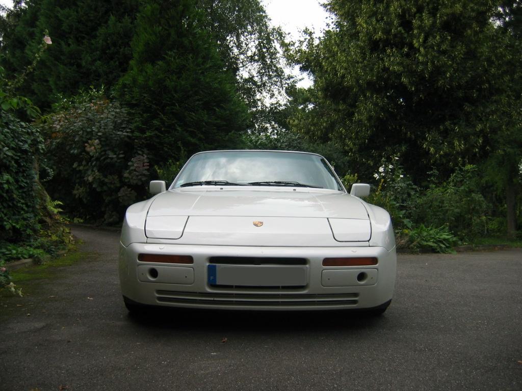

After giving up really early on my main beam failure in the bumper drivers light i have decided to go a head with plan B which was an idea i was planning any how...Im going to remove the bumper driving lights and replace with a smaller lamp about half the size and also fit air ducts for the front brakes...I don't know if any of you guys have done this conversion before but i will ask the questions anyway! Where the best place to buy the parts ( lamps and air ducts) i would prefer to buy parts that fit straight in if there's any such thing, i know gpr do a good range of ducts but there not really close to the size i need. Any ideas would be help full.

Thanks for all of the above but i want ducts that will fit in with a smaller lamp so i can still use the fogs and side lights..Whats VAC ,GRP im just a mere mortal human that buys thing from shops ...Any how the ducts are going on to a 944 s2, JS you know the one...Dose any one know the dimensions of the lamps in the front bumper of a 944 without the s2 or turbo front bumper ?

AH Ha now its all come clear,thanks...the vac process sounds good but i was looking to start job and finish within a day ... i went GPR in siverstone on thursday where they have a large selection of ducts in all sizes and they have the size i need(with a little trimming) so all i need to find now is a set of fog/driving lamps to fit the left over space in the hole which is 130mm x 100mm . once or should i say if i find them, i will fit the fog light bulb and then drill a small hole for the side light bulb...i think my task for saturday is to go round asda car park checking out fog light sizes [] .
I was thinking the same thing but Havant seen one to measure it yet unless some kind person on this forum could do it for me if they happen to own one...hint hint...I think i will be out looking for some small vw motors tomorrow to see what size they tend to use up front...
