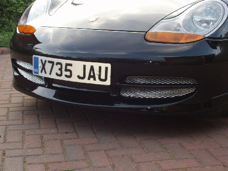

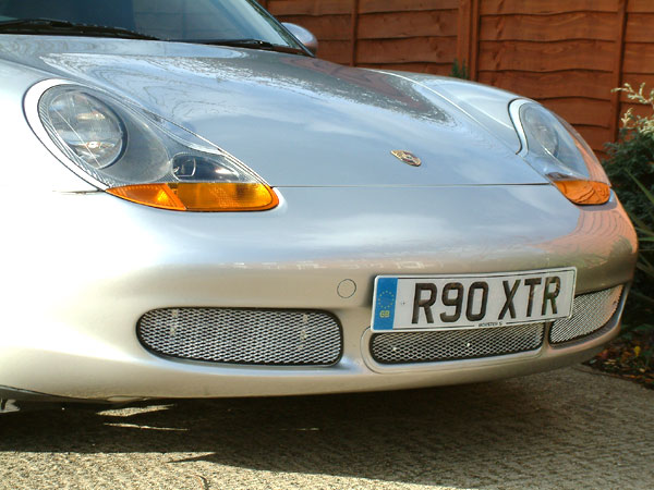

You say "easy peasy" but did it involve removing the bumper, or are they fiited over the existing grills?
If you look closely at the side vents you can see 2 silver vertical brackets per grill that fit behind the standard horizontal slats.
You DO NOT need to remove the bumper, if you have an 'S' then the middle one is the same but slightly fiddlier.
They only nip up as not to bend the standard fittings.
If you want a closer/bigger pic E me at the address below
