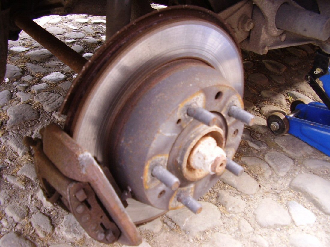

Can you find out the exact offset on the wheels, and take a pic of the hubs?

I will try to get the wheel off and get some pictures tomorrow evening. All I know is that the wheels are wide and the hubs are big. There are definitely no spacers and the passenger side tyre scrubs on the outside edge when the body squats down or rolls over a bit

Next installment of the wheel scrubbing issues.... It would now appear that I have been barking totally up the wrong tree...... have just removed the wheel and checked the offset printed on it...... it is ET15!!!! I have posted a pic of my hub as well but I am now presuming that I have late hubs and early wheels???
Yep that looks like the width of a late offset hub.
ET15 puts a 9" the wheel 40mm further out from where it should be. You need a late offset wheel with an offset around the 55 mark
