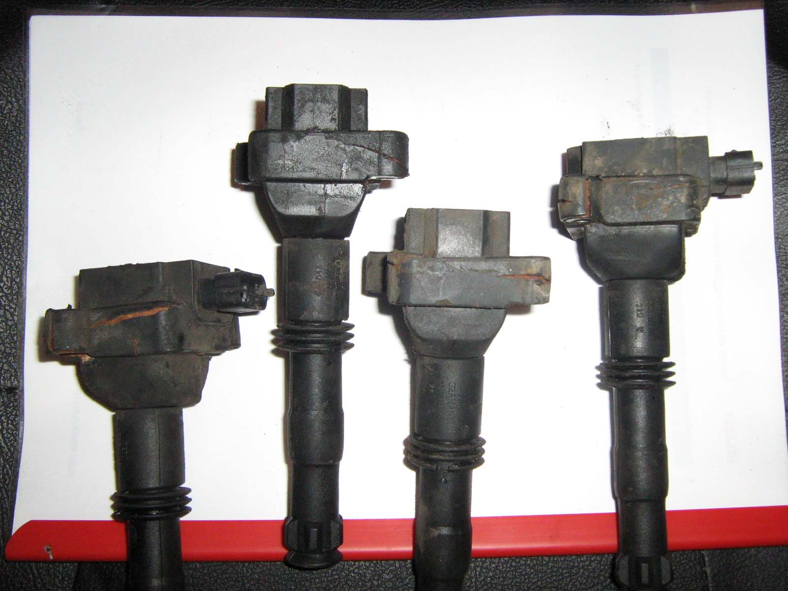

Just thought I'd post an update.
Replaced 6 coils and 6 plugs today.
Found 4 coils with cracks in - hope you can see cracks in the pic attached
Appears to run a little smoother now [;)]
Got silicon grease form RS as Richard advised - with a coating of grease, it made the coils harder to fit as air couldn't get out as fast.
Glad it's done, but don't want to have to do that too many times.

It's a fun job, but I found worth the effort and worth doing yourself if you want to save £££s.
