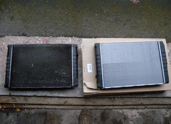

The rad is out, without disconnecting oil lines.
I couldn't take it out from below, as the underplate can actually come out only after the rad!
One thing is for sure, this was such an orgy of coolant that I doubt the garage floor will freeze the next winter!
Almost done, just have to fill with coolant and bleed.
Looking forward to seeing if I get lower coolant temp.
So it turns out the new radiator performs just as well as the old one.
I'd have better spent the money elsewere, but maybe I can pretend it was the last "important part" that I had not replaced since the new engine [8|]
At least when I open the hood now I can see nice shiny aluminium from the top end of the radiator [8|]
