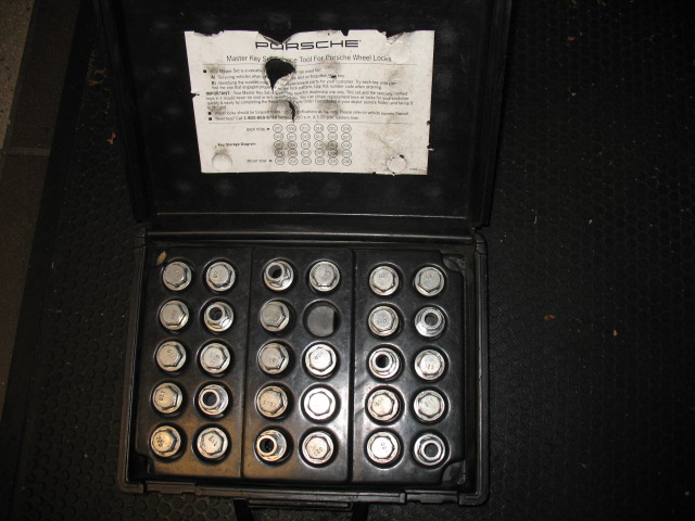

There are 30 keys for the locking bolts, so unless you know the number, then it is likely OPC only. I have heard that most of the workshops have a box of keys somewhere in the corner, and may help you out cheaper than you think, if you take the car there.

+ve...key can be obtained. However, you will need to take to opc and they will match it. Cost me around £25.
-ve even though they had a used one they still wouldnt sell it to me cheaper as they didnt want the risk of it snapping, Hmm!
I would go for the replacement from opc. Just think, if it was not an original porsche part you would probably have had to have the bolts themselves drilled out at a huge cost. I spent hours on this issue, but still eventually went back to opc to purchase. Good luck
