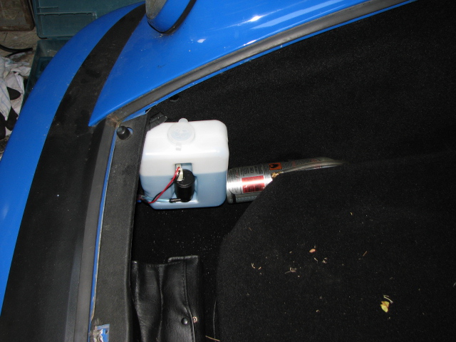

I have ditched my headlight washers altogether and now replaced my original washer bottle (which is huge!) with a nice simple aftermarket all in one bottle and pump from Ebay for £10. The windscreen washer work very well now. The whole job took a couple of hours and the reservoir is now under the bonnet and not trapping mud under the wing.
The intensive washer bottle you speak of is simply an extra reservoir for putting in special Porsche intensive washer fluid.
Love the tire inflator prop, [:D]
