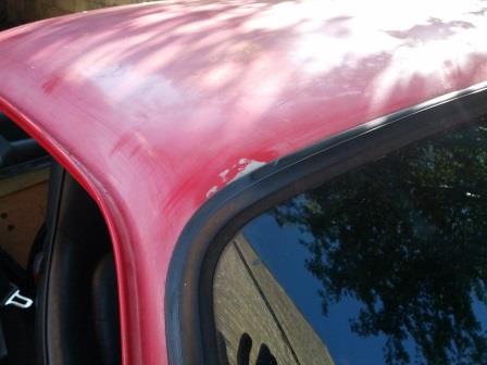

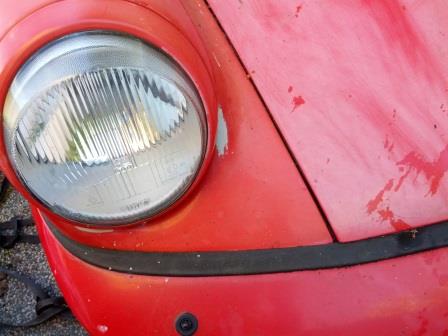

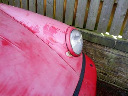

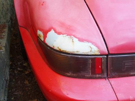

Nice pics!!! And an interesting project would love to do it myself!

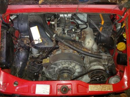

It looks like a full restoration is required. I would get a leak down test done to assess engine condition. Then change all fluids and crank over by hand. Disconnect the coils and then turn over to see oil pressure before trying to start.
It's going to need going throughly ie brakes,bushes,suspension,gearbox,clutch inc slave cylinders etc plus it looks like a full respray!
The 964 is fairly straightforward to work on in my opinion (but I am a mechanical engineer). Parts are quite expensive though and you can soon rack up thousands. The rear lights are about 750 for a set! And engine tin about the same sort of price. Keep us posted how your getting on with it

Personally I'd do what's been suggested, check the condition of the engine and clutch and then set about the body. You'll need to find out the causes of the rot and fix those as well. Rear quarter lights suffer from muck thrown up by the rear tyres which holds moisture each time it gets wet.
Check for mice infestation as they seem to like wire insulation.
It's amazing what a vacuum and a pressure washer can achieve.
Certain things like engine tinware are expensive and unavoidable if needing replacement. Other things can be repaired like the heat shield behind the rear bumper. It's amazing what a few rolls of aluminium tape tape can achieve.

My experience of the 964 is it has not got to the depth of decay that the torsion bar cars have. An average pre 74 car was a pure basket case 20 years ago, an average pre '89 car has now reached a poor state in areas of B-Post, sills, A-pillars, Scuttle front & rear, wings, front floor, fuel tank, rear light area, sometimes the roof rails.
What you seem to have is a lovely original Coupe that is in need of a tidy up. Anything you spend on it within reason will not be lost - the 964 Coupe is appreciating as the good ones get fewer.
The areas you will need to attend to are the Windscreen surround, (shell flex abrades the paint over decades and rust starts) sills behind the covers but nothing compared to a 3.2 carrera, scuttle where the wing meets it and down the inner wing top edge (remove wing to see) headlamp bowl area of front wing, tail-light area of rear quarter, engine tin, (try RedTek and speak to Roger for Fiberglass tins as opposed to parting with £1000 for new originals which will go the same way), rear bumper mount area may be corroded.
